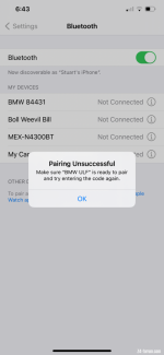

Still no joy
Can get pairing up, enter the code etc and then this
