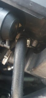

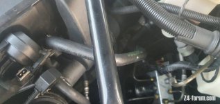

Our cars are getting on so, while I was doing the DISA and VANOS valve upgrades, I went over the the external hoses. What I found may well be typical of cars from that time. The first picture shows the vacuum brake booster hose....looks reasonable...until you turn it 90 degrees and then not so good. The hose was almost entirely collapsed, leading to very little vacuum being induced. Fortunately there was still enough to operate the brakes. Note: For whatever reason the photos have loaded opposite to their number, so look at the second picture first.

Visually the surface was almost as new....it appears to have just collapsed internally, over time, under the vacuum.

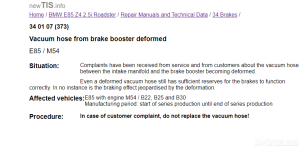

Interesting that BMW issued a TIS technical bulletin to dealers about this apparently common condition of squished vacuum hoses, quote
"A deformed vacuum hose still has sufficient reserves for the brakes to function correctly, in no instance is the braking effect jeopardised by the deformation. In case of customer complaint, do not replace the vacuum hose!
Technically they are almost certainly right, but it makes them look like a cowboy shower of s4it!
