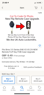

Probably just a problem with the lock button function on the key... have you tried using some wd40 or similar? Otherwise you could always cut the key up and try put it in a newer shape key? Certainly wouldn’t hurt if it’s basically useless anyway?
