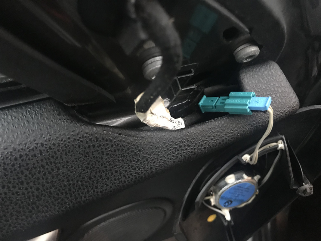

Smoking speaker!
I don't see a capacitor anywhere.
Do I need to take it apart further?
Smoking speaker!
If you have the 676 mid range amp which you replaced with the head unit that has 4 by 50 watts, depending how your wiring harness works it could have pumped 50 watts into the tweeter as the original system drives the tweeter of its own channel without any capacitors as frequency determination has been done by DSP in the oem amp...so no wonder it glows..
