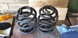

Solved!
The previous owner had one rear spring replaced last year which was pretty stupid as everyone knows you change then as a pair. Anyway the rear near side corner is higher than the off side now which is pushing the OSF down.
So I just need to fit another spring on the OSR and it should then sit level.

Yes, I should replace them as a pair but as the one has only been on for a few thousand miles it should be ok. But.... if i can't get the same spring, which might be difficult I will get a pair.

I have a part number for the rear springs 33536760605
Was there a m-sport suspension option or is it one spring fits all ?
- Davz
- Posts: 507
- Joined: Mon Jul 10, 2017 8:35 pm
- Location: Wellington, Shropshire
Ride height uneven
M-sport is a shorter spring, this will lower the car by 15mm (if my memory serves me well) when compared to the SE, so make sure you get the correct spring! Better still fit eibachs all round for an improvement in handling, ride comfort and appearance.
