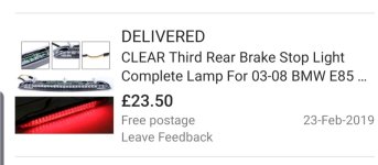

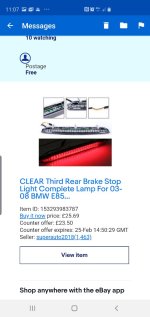

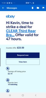

Did mine for the 3rd time again in my ownership on Tuesday pretty simple hardest part was pulling the broken one out replaced my BMW one with a Chinese copy one at £23 and am very happy with it even if it doesn't last as long as the BMW oem one I could buy 3 for 1 but to be honest looks as good quality as the oem as even that is not great.Nice write up for new owners as I am sure they will definitely need it

Could you possibly post a link for the £23 one for future reference as I too am not impressed with the BMW quality?bz4kev wrote: ↑Wed Apr 03, 2019 9:44 pm Did mine for the 3rd time again in my ownership on Tuesday pretty simple hardest part was pulling the broken one out replaced my BMW one with a Chinese copy one at £23 and am very happy with it even if it doesn't last as long as the BMW oem one I could buy 3 for 1 but to be honest looks as good quality as the oem as even that is not great.Nice write up for new owners as I am sure they will definitely need it
E85 3.oi titan silver,Maldives blue E85 3.0i gone but not forgotten
- Posts: 13
- Joined: Sun Nov 05, 2017 5:46 pm
So Easy Even I managed it...Center Brake Light
I’d also appreciate a link to a replacement. One end has come off mine so if a replacement’s that easy I’ll get on with it. Thanks
