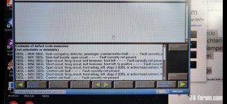

So tonight I got a little further having installed Revtors profile which I found actually tells you the correct module (CBD name) to select in NCS Dummy once downloaded from the AKMB ECU on the car. I pulled the information from the SBSL
module and imported it into NCS Dummy and got no errors
I then set Left Seat Occupancy Detection to 'Not Active', exported the MAN file and coded that back to the car in NCS Expert. I then pulled the Trace file again to confirm it had successfully coded - it stated 'Not Active'.
I then disconnected the occupancy module and turned off the warning light in BMW scanner 1.4 and the airbag light is still on. I then scanned the ECU on DIS and it's telling me I still have a communication error on SBSL. Eurgh....
Have I missed anything in NCS Expert - should I have deactived any further options related to the SBSL module?
JakG do you recall exactly which settings on SBSL that you set to Not Active as I notice there are a few more but they are simply check boxes with 'Value' number ranges 1-4?
Any ideas? Thanks
Any ideas? Thanks
