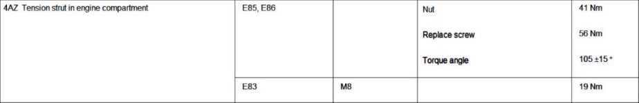

Front struts and lower metal undertray are worth checking. Both are structural, the struts seem to work loose over time and the lower is potentially due to bolt reuse if removed.
Lower plate: replace screws, 59 Nm plus 90 degrees
- 51 71 4AZ.JPG (20.87 KiB) Viewed 767 times

If it sounds like a metallic rattle that's exactly what I've just had, and it was a loose bolt on the metal undertray. Just recently replaced all the bolts as they're meant to be one time use stretch bolts.

Do you by any chance know the torque settings for the bolts on the metal undertray?
Thanks
Thank you for the advice.
Thanks
- Posts: 5277
- Joined: Wed Feb 19, 2014 3:01 pm
- Location: NW London
Knocking noise from front right hand side wheel area Z4 3.0si 2007
