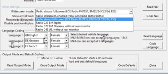

Hi,
I just purchased a 2006 E85 which was still running 2006 NAV firmware (SW 4-1/60), I attempted to upgrade the firmware to STOCK v32 and to v32.2 (the modified version). Strangely enough I am running into an error with both versions!
After inserting either OS update disk (burned using lowest speed etc), the car thinks about it for a moment, very briefly displays the languages it tries to install? Followed by language is not available. After this, the satnav does not boot up any more and the display remains black. (radio still works, even though it does not display it on screen) When reinserting either update disc, it only turns on, to advise the same message as before.
The satnav + display was functioning fully before the attempted upgrade, and also does turn on when starting these 'failed' upgrades. Hence, I think it is not a hardware issue. But most likely a software/firmware issue.
Any ideas, how I can upgrade succesfully, and get the system functioning again, are of course welcome!
Just to be clear, I am not asking about 'illegal' map updates, also I did try to find a historic solution, however it has proven to be quite difficult considering it is a legacy nav system.
Pictures added for reference, Thanks in advance!
p.s. The car is not in transport mode
p.p.s. As far as I can tell the mentioned languages are in both OS firmware cd's.

Update:
I have now been able to install stock OS v29. and the satnav+ display etc is fully functional.
I am still unable to install to v32 as the same error as above pops up.
Could anyone confirm the standard UK languages under the settings tab? Photo added below of mine. Seems non-standard having GB as an option 2x.
Would I need to get this recoded to GB D F (for example)
Or is there a known work-around to get v32 update to go through? (the only language I need would be GB).
Thanks

StuCracker and cj10jeeper,
Thanks for the replies, I thought the languages tab was a bit strange! And am still quite confused how and why! (and if this in any way affects the updating)
I've tried 3 different burns of v32 (modded and stock) all to no avail on Philips branded discs.
First try of v29 did work, next step will be to try to source v31 and burn to the same brand of disc. Unfortunately I will be unable to pickup some verbatim discs in the next few days. But is next on the list!

I've retried, and also have burned on verbatim cd-r discs, same result unfortunately. For what it's worth also cleaned the burner lenscj10jeeper wrote: ↑Fri May 11, 2018 4:30 pm Download the V32 from the web and try again. Eliminate 1 issue at a time
Unfortunately pulling fuse 49 did not make a difference.StuCracker wrote: ↑Fri May 11, 2018 4:59 pm
Would it be worth trying a reset of the sat nav to see if it sorts out the language setting?
The facts so far: V29 works.
V32 installation fails due to: A language you've selected is not available. (the screen shortly before shows GB,F,D)
Under Settings: I have a non-standard language selection, showing GB 2x and only German as another language.
I think my next step will be to try v30 or v31 (if I can find them) to see if the same problem is apparent. And from there, decide if recoding the nav languages at the dealer to GB F D might be the next step? Unless anyone else has a solution??
