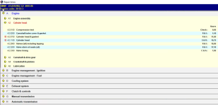

Does sound like head gasket especially as it's pressurising. Needs proper diagnosis though as stated, using a chemical or pressure test before jumping in.
The head gasket set for these isn't cheap at around £250, but it's worth doing properly if you're having the head off, so I'd be grinding the valves and be replacing the stem oil seals.
The head gasket, cam cover and exhaust manifold gaskets alone are about £160, so there's not much of a saving after by not going the whole hog, especially after another £30 for the head bolt set. Not sure what the labour time is, but I'll check Autodata when I get a sec.
I've got a 3.0 Zed with same symptoms waiting for me to do.
