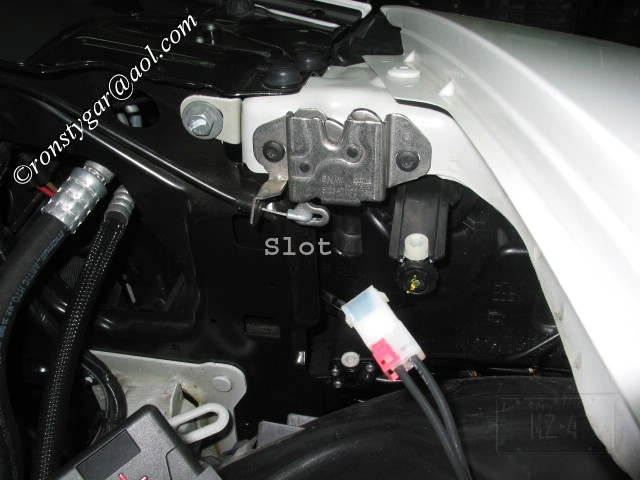

went through the grilles pulled the cable and can feel the wee "cog" that must move back to let the loop on the bonnet pop up past it, but it is not budging at all
with a long screw driver do you go up through where the cable feeds in or are you come from the opposite side ? my latch is not like this one
like this
it's a vertical cable and spun 90degrees clockwise
edit > changed the bottom picture, maybe can go vertically up the left hand side oft hat and catch the clip not much to hit though
