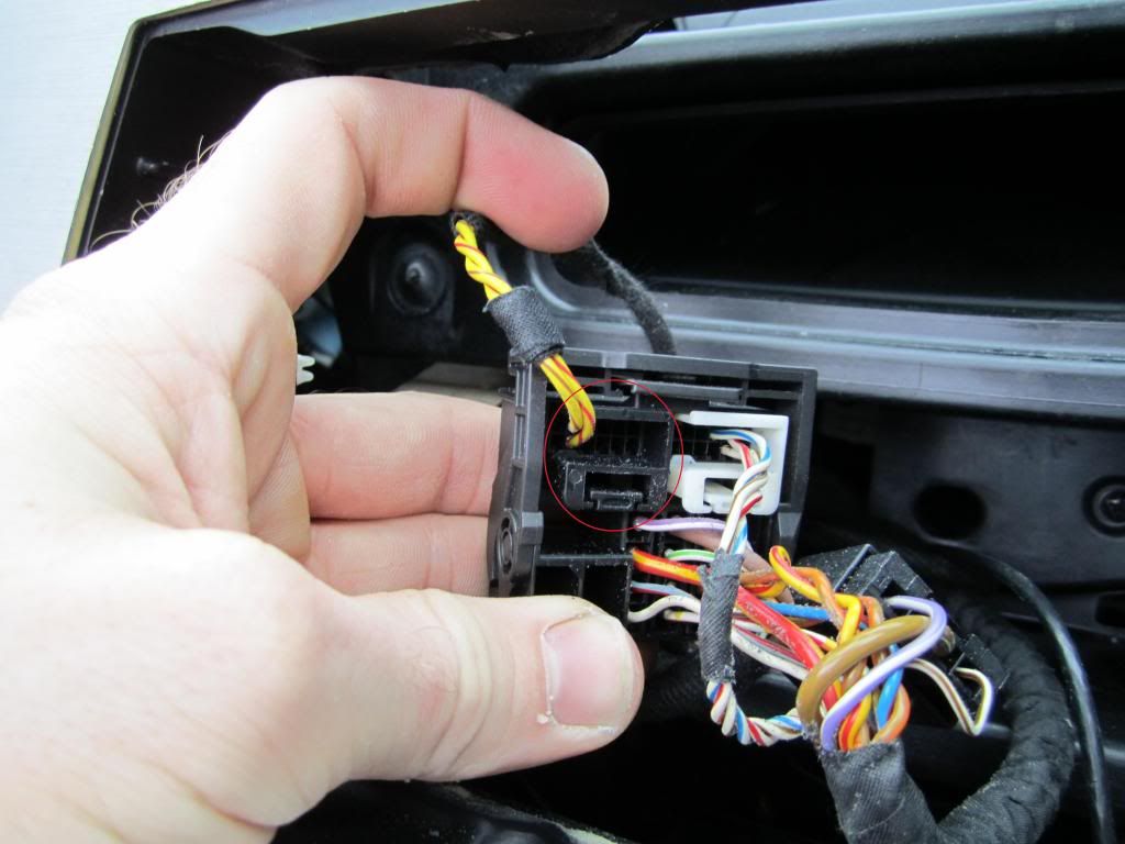

Connect all the parts for the satnav. Firstly connect the screen and Proffesional radio to the looms. Also connect the 2 wires on the loom to the back of the block on the harness that will attach to the back of the radio. You may need to buy the pin block circled for this as mine was missing. The radio and screen don’t have to be in situ at this stage.
