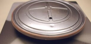

Once your etch primer is properly cured, it’s time to put on the sanding primer. This is a multi step process that helps smooth everything out. First I put down two coats of the sanding primer and made sure I had a nice smooth uniform film.
Then once it was cured per the cans instructions, I sanded it with 400 grit sandpaper. Don’t worry about sanding down to the green etch primer. Just be sure NOT to sand through the etch primer to the metal other wise it’s time to start over.
Repeat the painting / sanding step until you are happy with your results. How much time you initially spent sanding the aluminum down will dictate how many coats of sanding primer you’ll need. The smoother the substrate was to start with, the less primer you’ll need. I ended up with just 2 coats of primer until I was satisfied. Don’t be worried if you see some etch primer still coming through the black. The way we’re going to put on the design will help hide the minimally ghosting that’s still left. As long as it feels relatively smooth to the touch, you’ll be good to go. Here’s my finished results:
Step 7.3
Now for the last bit of painting, the basecoat. Wipe down your sanded roundel with acetone once the primer has fully cured in order to remove any dust that may have remained. Don’t worry if your rag gets a little bit of black transfer, just don’t saturate the part so that the primer begins to soften. If this happens, put the roundel aside for a day and let the coating regain its hardness.
The basecoat is pretty simple and straight forward. Again, be sure to use multiple light coats of paint. We want full color development and we don’t want a grayed out coating. Once you have a smooth finish, let it cure out for a couple of days before continuing. We want to make sure all of the solvents are out of the paint before we begin applying our image. Also, it’s important to have a smooth appearance here with no grit / dirt in your paint otherwise that will show through image. Feel free to wet sand with 1800-2000 grit sandpaper to get it smooth as possible, since I work in a clean environment that wasn’t necessary for me.
And here’s the front of the painted roundel sitting in the black back piece. The black rim will nicely frame out my design later:
