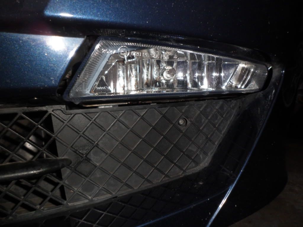

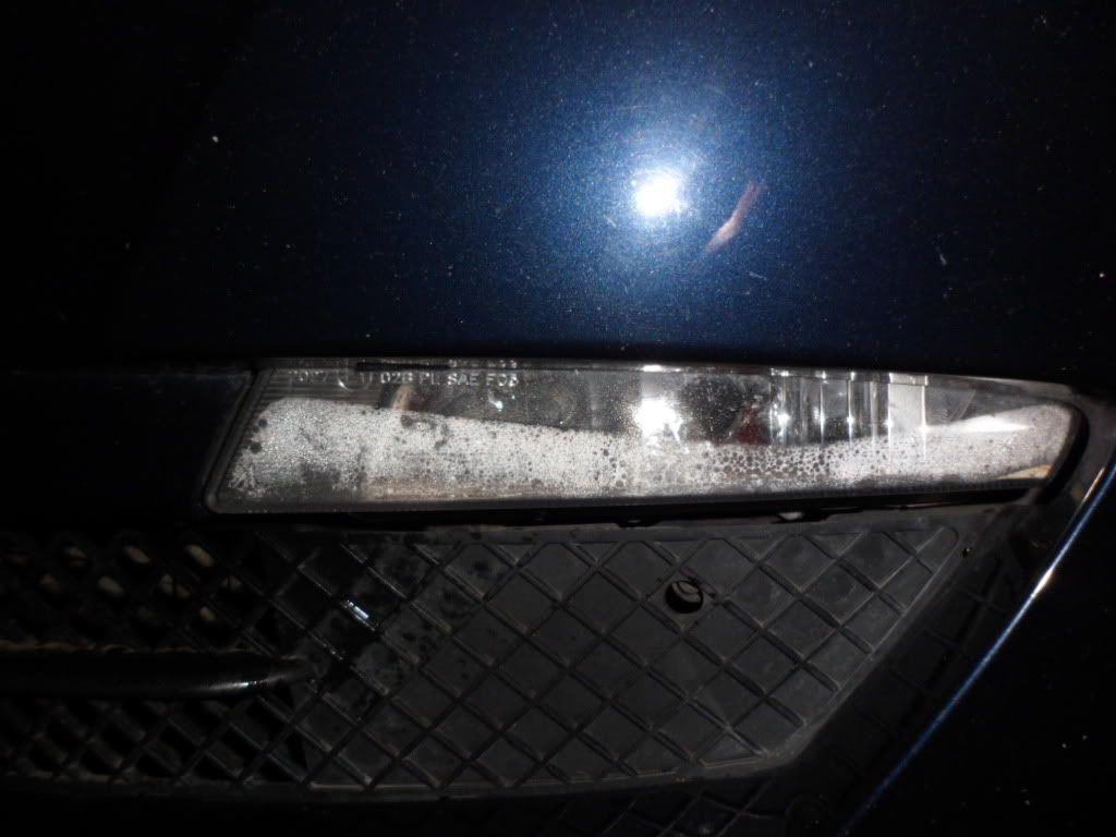

Hi all-i thought i would document this,i dont know if it would help anyone-
Before-

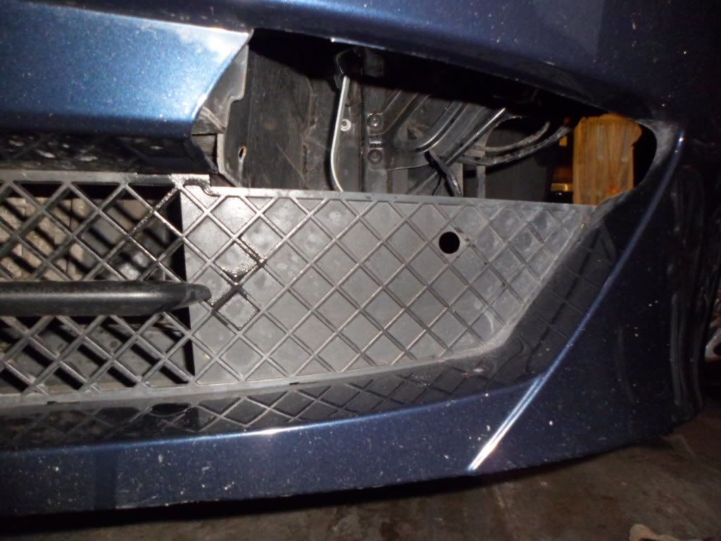

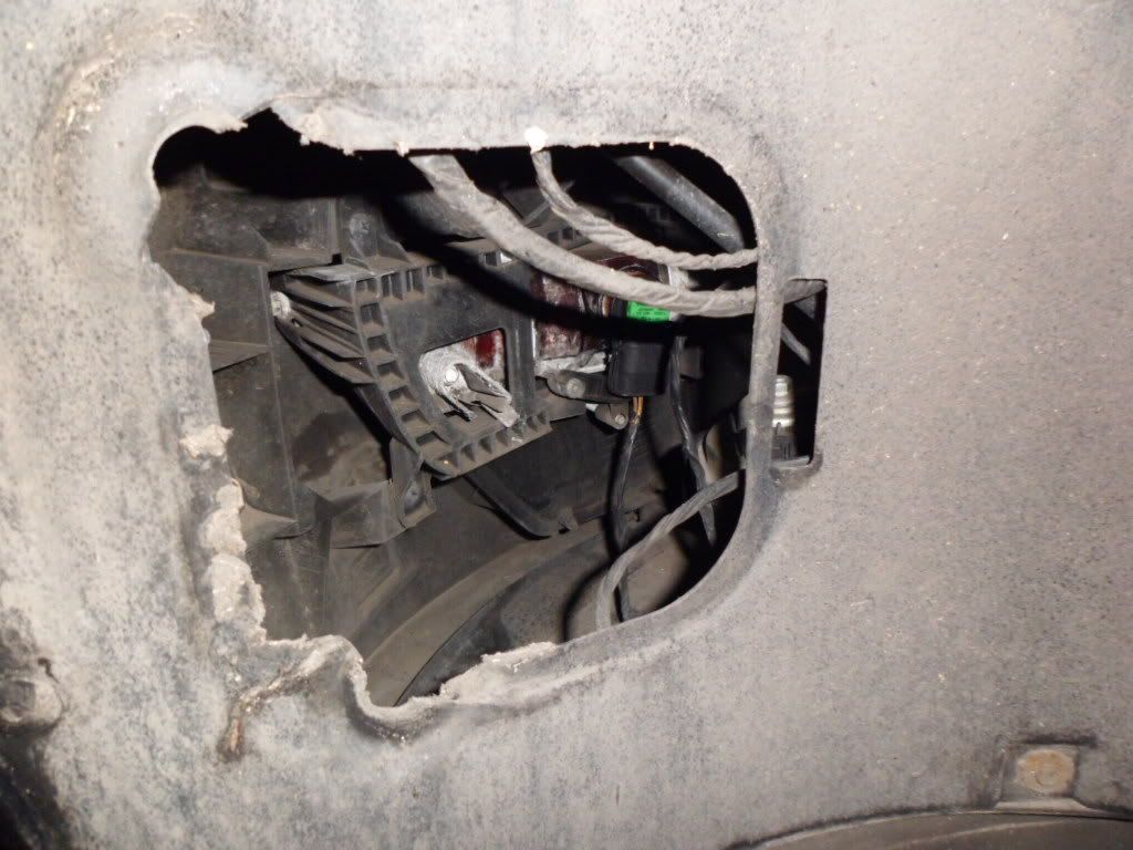

After wheel removed,remove the cover-
Unplug wire to lamp,remove the two screws inside,and one on the front of the bumper-

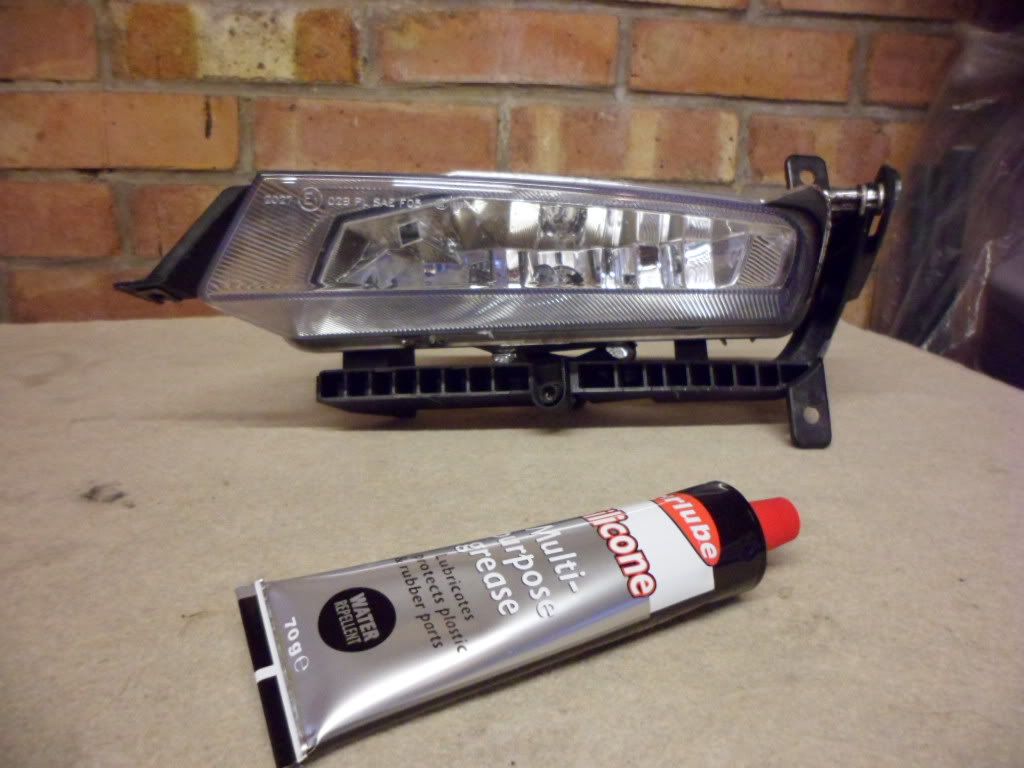

New lamp unit with silicone grease i used for the joint(i dont know if this was overkill,but i used it anway)
I covered the front lens with a cloth to protect it as i wriggled it home,i pulled the cloth out of the front opening,put the three screws back,connected the bulb back,replaced the cover and wheel to give-
Same for the opposite side obviously,i hope this helps anyone wishing to do the same.

Wow - that's some moisture ingress there Andy. Did these have rubber seals initially, and if so, have they perished? Nice write up btw... :thumbsup:

markeg wrote:Wow - that's some moisture ingress there Andy. Did these have rubber seals initially, and if so, have they perished? Nice write up btw... :thumbsup:
Cant seem to see any rubber on them mate?

Good luck with the new lights. Wonder why they keep misting up, is it because they don't get much use?
Cheers Mike-i suppose its so BMW can extract regular funds from peoples wallets! :cry:
