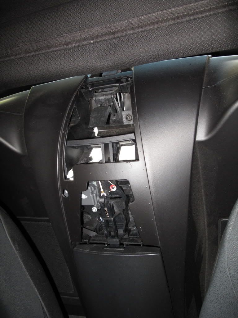

My Latch broke a few months ago. I learned how to open it w/o the latch. Someone emailed some pics, but no one has done this post.
First I went to Real OEM parts. The diagram is not clear if the cover assembly actually comes with the latch that was broken. I had to call Pelican Parts and they didn't know "for sure". I ordered it anyway and it did come with the two latches.
Part No: 51467031364
Broken Latch
Unscrew two torx screws
After screw removal, pop little screw retainers out so you won't break them. I broke mine.
Gently peel up and out. It comes off. It has snaps in about the middle and at the very top.
Place the new one in and snap at the top, middle, and hold in place at the bottom while placing screw retainers in the bottom. Re screw in.
Finished.
Takes about 20 minutes to order on-line (about $60-70 US).
Takes about 10-20 minutes to complete.

Well this was quick and interesting.
First things first. As with most 2 seat roadsters, you will need to be suspended upside down from a hoist with shackles around your ankles. This will give you the proper vantage point.
I started by un-clipping the retainers from the top. Then the second set of retainers, then the third. These should come out easily, especially if your roadster has sunburn. They'll just break.
Once the retainers are unclipped, you have the final attachments to remove. The two screws at the bottom (very fuzzy in the OP photo). These screws are plastic and did not match any of the philips or torx bits in my many tool sets. They're hex. Fortunately they had no torque on them, so I was able to carefully remove them with a large philips bit gently caressed between my thumb and forefinger.
Once these screws are removed, pull the cover ever so slightly downward to release the retainers that the OP broke. These retainers are expansion rivets.
If you carefully removed everything these expansion rivets will still be lodged in the holes of the panel. Pinch them from the backside and remove them for future use.
Clean out all of the broken pieces of plastic, and lever springs. s**t will be everywhere.
Replace the panel by snapping in from the top, then the next set of retainers, then the next. Smack it gently with the back side of your fist to lock the retainer clips.
Then align the lower panel holes with the receiver holes in the console. Press the expansion rivets through both holes. They press through both the tab on the panel and the receiver hole on the console. Remember, they're expansion rivets. And they're plastic. And they're old, and delicate after years of whatever.
Thread the crappy plastic screws into the retainers and tighten as removed, (with a large philips bit gently caressed between you thumb and forefinger).
Done.
Except, your console light may no work. Don't worry, it will come back on after you close and open the driver side door.

Hope you're still checking your site; my 03 z4 needs new covers for the center console. I bought them online but neither one is going to go on easy it seems. The bottom one looks odd. It appears that some of the old plastic is still attached to the car, the part with the very small screws, possibly the Philips headed ones you referred to above. I don't want to break anything vital so i'm not sure where to begin. it would help greatly if I had a good diagram. any ideas? :headbang:

Mine too broke, tbh bmw design puts stress on the center 2 support arms, also the gaps where the 4 supports go through has large gaps, Im guessing that over time we dont always press the button straight but on a angle that eventually snaps the supports.
As i couldnt be bothered ordering a new one, heres my fix, works perfectly no play in the movement
Basically 4 peices of plactic cut to shape of the supports then epoxed into place, they all still fit through the original gaps.
If i had time, a 3d printed support might have been better to go inbetween each one, either way yor cant see them from within car.
Guess we will see how long it lasts :)
