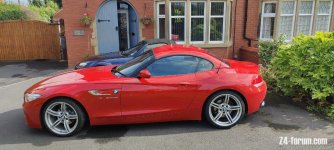

So, after 35+ years of motoring I've taken my first steps into upgrades with a Superchips Remap. Next for the new steer I'm looking at the possibility of changing the 19" wheels (with run flats) currently fitted for 18" versions (with normal tyres). The 19" look great, but the ride really is too hard for my local roads (and old back!), and I quite fancy changing to black wheels.
So, first question: Will a wheel change really make that much difference to the ride?
Next, can anyone suggest a decent website for the wheels/tyres.
What options do I have regarding the size of tyres? is it best to stick with a proven setup?
Next, is there a decent demand for selling the 19" wheels, which I believe are 326's?
What price would I expect and where is the best place to list them?
The rears had brand new tyres fitted for the MOT a couple of weeks ago, the fronts are okay.
