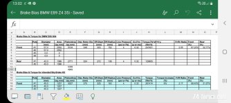

I'm not without conclusive evidence that it's necessary. I'd also want to understand exactly the impact of the change would have on the software if not a normal BMW change.
The discussion on the German Z4 forum was not conclusive for me. They do it for F series. Welcome to more information if it's available now.
The actual balance shift is not huge - 2.05 vs 2.17 F/R. When you consider the factors that influence the system I'm not convinced the system can't already cope with this change. Factors at each wheel: surface, tyre, environmental, and brake pad/disc. Each wheel can experience significantly different levels of grip.
I think the sampling rate of the sensors will be key to the effectiveness of the system.
I tried to upload the spreadsheet that calculates brake bias but I can't so screen shot attached. I found it on another forum.
Rich
Rich

OK, would be interesting to see brake bias calculation for your specific setup.
I found the brake bias spreadsheet online but can't find original source to link. PM me with email address and I can email over.
Rich
Rich
