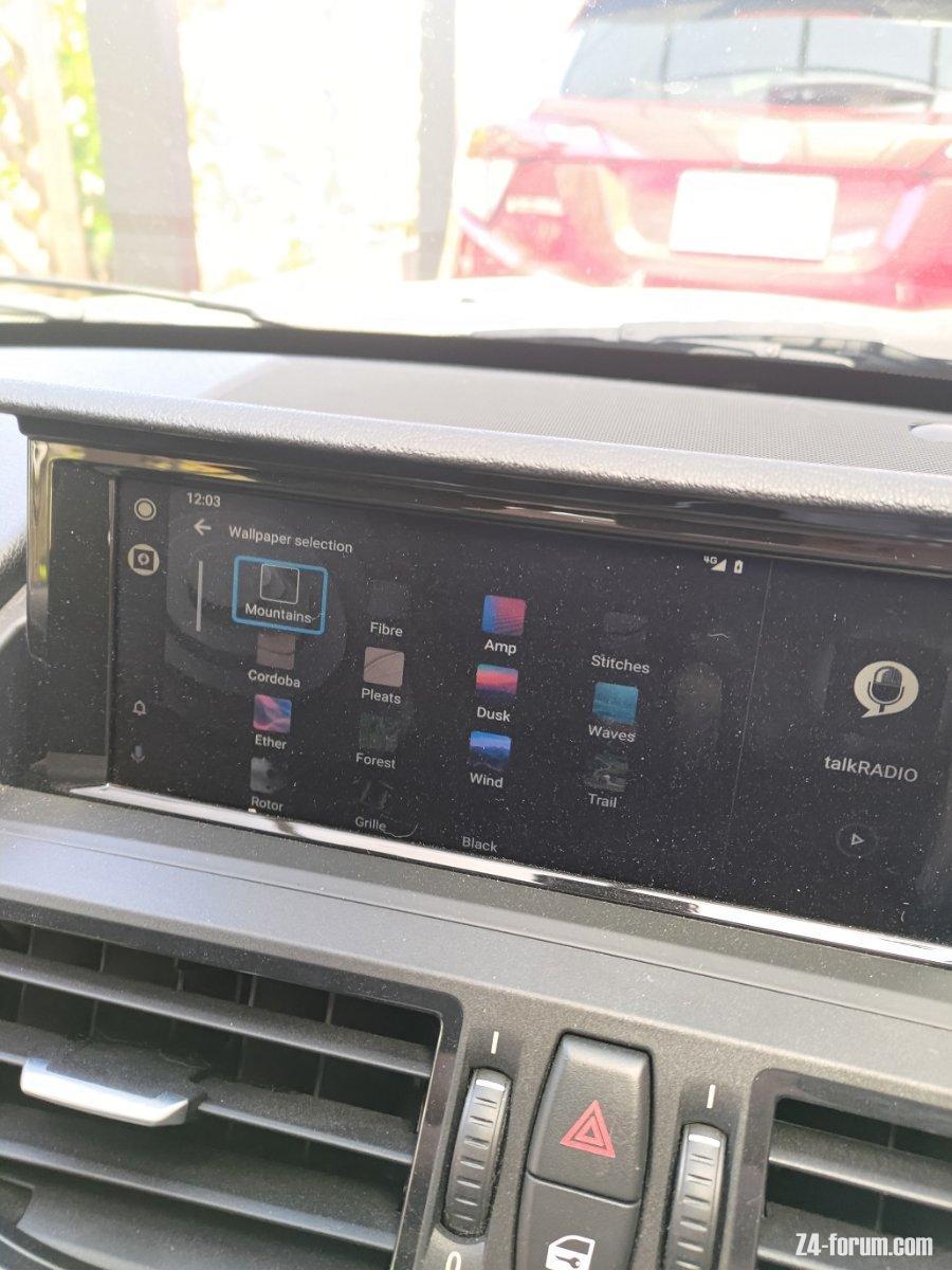

In the settings here:

Roddy wrote: Sat Apr 10, 2021 4:10 am In the settings here:
Appreciate the pics - thanks :thumbsup:

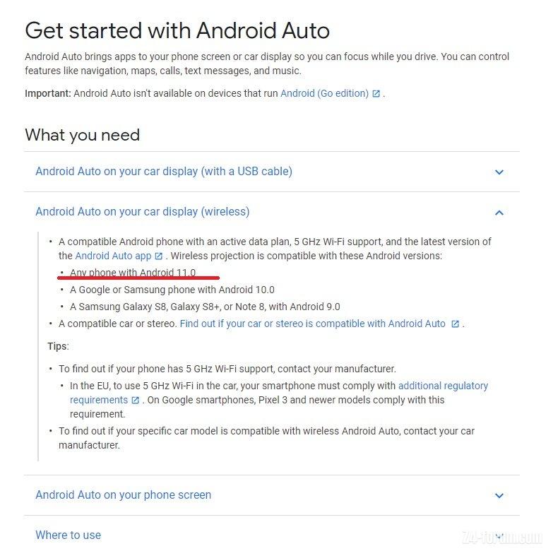

It seems Android auto wireless requirements may have changed. According to the Google site the requirement is as below. Not sure if this applies to the Andream box but I'll try it soon. I updated my Zenfone a few days ago to Android 11.
I have asked the support team, waiting for a reply.
auto 11.jpg (76.86 KiB) Viewed 1619 times

Update, my Zenfone 7 with Android 11 now pairs and works wirelessly, just as Google mentioned. Tested earlier with Google maps and some UK radio, seems OK.
I did ask the manufacturer's support guy, he had no idea, just repeated the old list of compatible phones, which it seems was a Google thing (?) not a limitation of the box as can be seen on the pic I posted before.

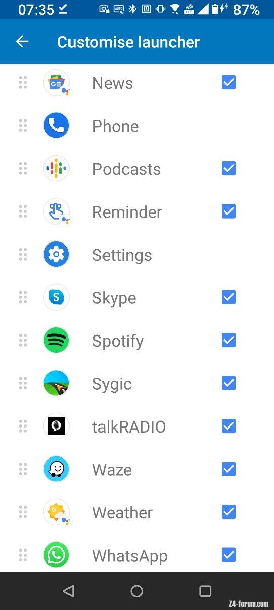

Also some other changes, there are now more apps available on Android auto. Sygic maps, Whatsapp chat and Skype have now appeared, if you have them on your phone natch. There are probably others that I don't use too.

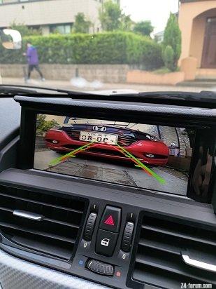

Left the house, went shopping and the MMI worked automatically as it has done since the Android 11 update. Backed into my drive and saw this:
What's wrong with that I hear you cry.... My wife's car isn't blue!!!! Who the feck?.....

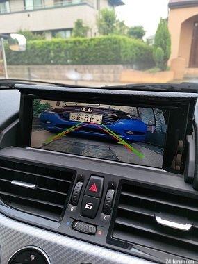

Put the car into park, tried again:
Wtf caused that? :?
