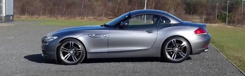

Z4 28i (E89 2014) - mineral grey

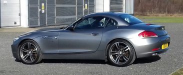

This is my Zed. Non M sport with standard suspension. I've got 235 x 35s front and 255 x 35 rears and in my opinion they fill the arches nicely. On level ground the gaps around the tyres and arches are spot on. I don't think the rears are too tall. The car does sit approx. 15mm higher at the rear but I don't find it an issue.

del_tl1000r wrote: Fri Jul 12, 2019 2:19 pm I've got 235 x 35s front and 255 x 35 rears and in my opinion they fill the arches nicely. On level ground the gaps around the tyres and arches are spot on. I don't think the rears are too tall. The car does sit approx. 15mm higher at the rear but I don't find it an issue.
Looks really good. My msport suspension will be a little lower than yours (10mm?), but I think this may only be at the front. No issues with having 1/2" larger diameter rears than fronts?
