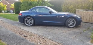

In the mean time here is a recent picture of the car so you can see visually how it compares.
2012 plate 28i btw
Different angle different day
