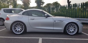

These are the Riva DTM wheels on DibbleCorse‘s car from an earlier thread. According to the details he fitted a 10mm spacer on the front wheels which I may have to consider.
