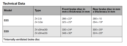

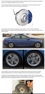

Sorry, but that make no sense. Sdrive 35i Z4 rear brakes are 324 mm whereas M5/M6 brakes are 394 mm, nearly 20 percent larger and feature an aluminum bell. Braking is largely about leverage. Bigger disc yields greater braking leverage. Larger disc also absorbs more heat. The aluminum bell helps offset weight of a larger disc. Front discs are 399 mm whereas Z4 discs are on the 35i are 348 mm, 13 percent larger.....and six piston aluminum calipers. These brakes stop the 4300 pound M5 in the same distance as a Z4 that weighs nearly 1,000 pounds less. Just imagine the braking capability of these brakes on a Z4.
In addition, the reviews I've read show brake fade an issue on the Z4 and I have experienced this as well when running hard through canyons. I doubt there would be any fade with the M5/M6 brakes on a Z4.
