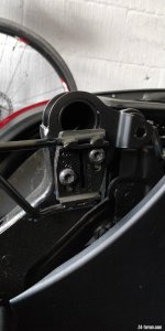

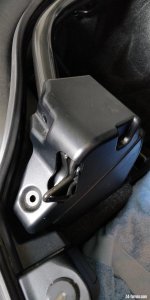

- cerbera
- Posts: 348
- Joined: Mon Aug 10, 2015 8:55 pm
- Location: Preston, Lancs
Solved...E89 Boot Lid Adjustment?
If you remove the shroud from over the latch at each side you'll see two torx screws that hold the latch on slotted holes. Loosen the screws and adjust where necessary. Before loosening I'd add a witness mark so that you can easily see how far you've adjusted the latch.
Hope that helps.
Hope that helps.
