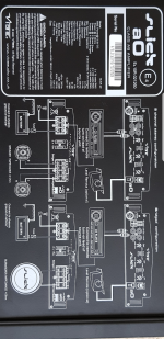

This is the Amp I am using,del_tl1000r wrote: ↑Wed Mar 21, 2018 9:19 pm I don't know how you have configured your system but I split the signal for the tbe front speakers through a line out converter to a 2 channel amp. The gain adjuster is wired between the LOC and the amp. One channel feeds the components and the other channel bridged to feed the sub. For the sub you will need to switch the low pass filter on and adjust the frequency to tune out all the vocals and higher frequencies. I see your sub is also a dual voice coil so you need to be careful how you wire this to match your amp. Can you tell me how you have wired it all up?
Can you suggest the best way to wire it up please ? Also thinking I could do with a bigger amp ? Gain is almost right up.
Thanks

Hi again. I had the 6 speaker set up. Woofers in the footwells, mids in the doors and mids at the shoulders. No tweetets and no amplification other than the head unit. The signal level going to the rear speakers on that set up is dire!! That's the reason I used the signal for the front speakers. Is that the same speaker set up you had? I used the signal for the front speakers and used an LOC that takes the front speaker signal,1 input-left and right and splits into 2 outputs. That then allowed me to to send the same signal to both channels of my amp. One channel for the sub and one for the components. If you have the same speaker set up as me and you've used the rear speaker outputs to feed the amp and your sub then this could be the main issue. What head unit do you have? I kept the original head unit (professional)IMO I think if you're running an amplified sub you should really be running amplified components. You also mentioned that your gain is maxed out. Remember, gain is not volume. You should never have it up at max. I can see from the pics your sub has a max of 1200w. What is it's RMS? The RMS of your sub should be similar or slightly less than your amp.

I've tried to find some info on your subs RMS but can't seem to find any. I'm guessing though that your amp is way underpowered as you suspected. This, along with using the signal for the rear speakers, if it's the same basic speaker set up I had, is definetely going to cause you problems.
