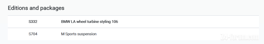

All pre-facelift 3.0i cars irrelevant of variant (SE / Sport / M-Sport) came with M-Sport spec suspension, ie 15mm drop on the standard. The 2.5i and smaller had the suspension differences from spec to spec.
For example, mine is a 3.0i SE spec, but came with M-Sport suspension:

TheDan wrote: Thu Sep 16, 2021 3:58 pm All pre-facelift 3.0i cars irrelevant of variant (SE / Sport / M-Sport) came with M-Sport spec suspension, ie 15mm drop on the standard. The 2.5i and smaller had the suspension differences from spec to spec.
In terms of other differences, there are minor things such as if it was built post Oct 2004 the cruise control wiring loom was removed. Previously the loom was present whether the car was specced with cruise control or not.
I see, if I put my number plate into a checker (Ck53ksf) it comes up 3.0i so i guess it’s either sport or M sport although difficult to tell. If you put in an se car from auto trader they all come up 3.0i se as yours probably would.
Yes, the 3.0 SE came with M Sport suspension, and thus lower. The only other M Sport option was seats @ £475, which were relatively rare at the time. Some commented at the time they were too narrow but I guess it's all relative. Hard to believe 17"s were standard too.
