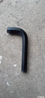

I used a 14mm allen key, cut down a bit with an angle grinder to get it to fit.

Thanks for the tips. There seems to be a hex drain plug. Couldn’t see the fill plug area well bc the car was not on a lift. Ordered today new plugs and washers so I’ll both types available and give it a try in a week or so.

I also have a 14mm hex bit, in the bigger size screw bit system (don't know exactly what its called), and with an adapter I could get it on a torque wrench to fit inbetween the diff and frame.
