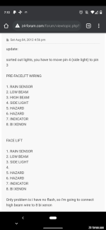

Well thanks for your reply’s ,what it is is that my bi Xeon head light units are shot to bits ( hardly work) and to replace them with brand new bmw ones are £ 2000 for the pair or about £600 second hand on eBay so I have brought cats eyes led lights which only work on a halogen wiring from the computer ( two wires) and as my car has bi Xeon wiring from computer(1 wire) they will only work on normal beam,no high beam I have taken the car to two garages one is z4 garage and they can’t do it I have looked on line and have heard you can do it and contacted car electrical so called experts and no one knows how to do it I really would love to keep the led (halogen) units as they are black unless anyone knows where to get black bi Xeon units I would appreciate the help

what year is your Z4 as the wiring change on 2006.
Low beam/high beam (Z Series_Z4-E85/E86 up to 2006_01)
this might help https://bmwteka.com/wds/en/e85/5014b830
Low beam/high beam (Z Series_Z4-E85/E86 with Xenon lights as of 2006_01)
https://bmwteka.com/wds/en/e85/875ae7c4

Thanks for the reply but no one who has replied understands what I’m going on about I’m down grading from a bi Xeon wiring from the computer to a halogen unit (led) which runs on two wires the bi Xeon run on one wire so I will have no high beam
