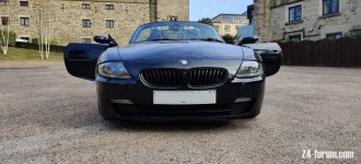

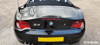

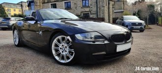

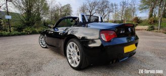

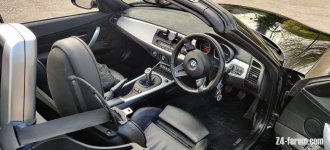

Anyway, some pictures. The car has lots of swirls, some paint imperfections and the aforementioned damage to the bumper. But with some Turtlewax Hyrbid Black Polish + Hybrid Black Wax she does look pretty good - at 2/3ft away. Up close, only a proper machine polish will further cover up some of the issues.
Sunny weather, 32mpg on my commute and a great soundtrack is all making ownership enjoyable. I never wanted a Z4 until I did and im glad I ditched my 986 for this. I do feel the car lacks low end grunt though so ill be having it dyno'd when time allows.
