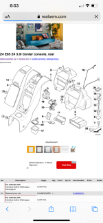

Found the micro switch and can see the actuator- can’t see how mine needs adjusting just yet
From realoem, is the switch 10 or 18 on the diagram? I can’t decipher
Is it a sod to get to?

I think it must be item 10 as 18 is the shoot bolt that should activate with the central locking. I removed mine as it didn't work & failed in the locked position.

Cheers Daveoldgitdave wrote: ↑Thu Jun 17, 2021 7:24 pm I think it must be item 10 as 18 is the shoot bolt that should activate with the central locking. I removed mine as it didn't work & failed in the locked position.
This is it.
Will have a look see if I can figure it out

Stu, take a look at pages 3 & 4 in this pdf https://www.bavauto.com/media/imports/i ... ins257.pdf. Should help you get to the microswitch .

Interior light question
Maybe I’m just wary of breaking 18 year old brittle plastic
I can’t get the arm off- it feels very attached…!
Any tips?
Found the micro switch it seems ok but the armature isn’t getting anywhere near it? Possible that’s snapped off a bit?
Any tips?

So is the light working as you operate the microswitch then? If so it does seem like there's a bit missing. Anyone near you with a Zed so you can check? Would it help if you take a pic of yours & I'll happily take a similar pic of mine for comparison. I'm not going to strip mine down though . .

I’ll get a picoldgitdave wrote: ↑Sat Jun 19, 2021 1:03 pm So is the light working as you operate the microswitch then? If so it does seem like there's a bit missing. Anyone near you with a Zed so you can check? Would it help if you take a pic of yours & I'll happily take a similar pic of mine for comparison. I'm not going to strip mine down though . .
Can deffo see the micro switch and it’s seated position, which to me looks ‘right’
Just not sure how long the armature which activates it on the door is supposed to be
A photo for comparison of that will tell me if mine is short
