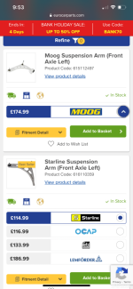

This is what I was looking at: https://www.ebay.co.uk/itm/202897370835 ... %3A2334524
The only worry I have is I'll buy one myself and have no one to fit it. I'm based in London.

Front Suspension Arms
Cheap and cheerful bud
Buy at your risk- I wouldn’t personally
If you want to help and fancy a trip to Lincs I’ll show you how to fit new control arms and bushes!

I wouldn’t go less than lemforders myself
