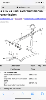

The gear change between 2nd, 3rd and 4th became significantly poor, feeling very notchy and making a noticeable clicking sound.
My immediate thought was something amiss with the linkages/bearings and not the gearbox.
The easiest one to check first is the lever bearing/bush as shown in the attached image I copied from the bay (just need to remove the gear lever gaiter and rubber cover) I had a mental image of part of the bush broken up however with the rubber cover removed I could see what the problem was....covered with what I can only describe as a hardened black gunk, sorry for lack of a pic.

Just tried to remove the boot (item 8 in the picture) and it isn't moving without a fight. Given up.
