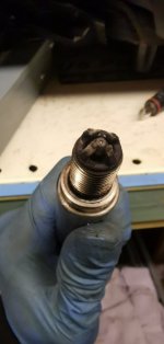

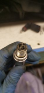

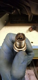

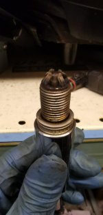

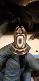

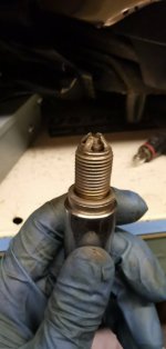

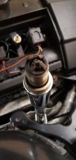

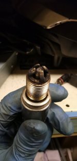

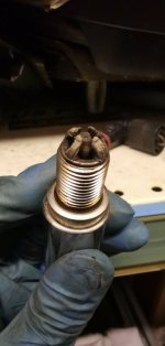

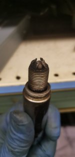

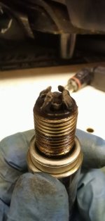

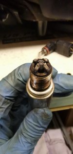

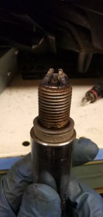

Removed spark plugs and got photos of them as promised earlier. Gave them a good clean with brass wire brush and brake cleaner - came out okayish.
Pics of each spark plug below:
Spark plug 1:
Spark Plug 2:
Spark Plug 3:
Spark Plug 4:
Spark Plug 5:
Spark Plug 6:
I then cleaned all the spark plugs. They all looked more or less like this...
Re-installed them and tightened down to correct torque spec and connected all the coilpacks back up.

Although the electrodes in your spark plugs look alright, the amount of filth on them surprised me. I would personally change the plugs & coil packs as preventive maintenance (which will also cure your mis-firing I bet).
" Although the electrodes in your spark plugs look alright, the amount of filth on them surprised me. I would personally change the plugs & coil packs as preventive maintenance (which will also cure your mis-firing I bet). "
I agree, I would throw those plugs and replace them, they aren't expensive after all.
