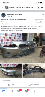

Post by Quijibo Jones » Mon Jun 17, 2019 4:26 pm
Sorry another question. Does anyone know where i might find the paint scheme/code for the car? there's a bumper on ebay that might be perfect.

Paint code should be under the bonnet on a sticker on the drivers wing.
3 number code with a / then another number. mine for instance is 453/5 midnight blue.

Post by Bing » Mon Jun 17, 2019 4:32 pm
It will be sterling grey - I *think* the paint code is on a plaque in the engine bay with the build date etc on it, but not 100% sure
Edit - there you go :)
