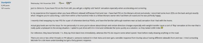

Mixing Tyres/Poor Handling
Mine’s in Bar on plate
2.1 bar 225=30.458 (30.5)
2.2 bar 255=31.908. (32)
is 32/34 in the manual?
- 3E23CEA7-D1CD-40E4-A3D4-F29FE300CBB7.jpeg (366.43 KiB) Viewed 863 times
