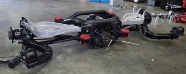

^lol yes that is exactly the same setup I used too, with on one side the cup from the kit and on the other side a socket that fit. (on those outer joints)
And I also heated up the subframe a bit to get those bushings going (TIS recommended to burn out the bushings I believe but thats quite extreme, a light heat does the trick ). Indeed fitting the cups on that spot is tricky.
Here was my old bushing collection I didnt have to saw/cut the rubber of the trailing arm bushing, I just pressed it out.
I looked it up, I did this job in 2013, 6 years ago. Time flies...
I completely painted the rear suspension and bead blasted the aluminium parts to get rid of the corrosion:
As you can see I used the red strongflex ones for the subframe and the yellow ones for the suspension, so a shore80a and 90a mix (I use shore80A for all the monocoque contact points)
