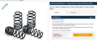

Looking to improve the aesthetics and reduce my arch gap, however its a daily drive and I commute through speed bumps and poorly filled potholes. Currently on SE springs and rides quite smoothly, so not wishing to compromise too much but really want it to sit a little lower and improve the stance. I'm really only wanting to swap the springs, I don't want to tinker with anything else on the suspension.
These are the H&R springs I'm looking at - its a 35mm lowering, which doesn't sound much at all?
Comments, recommendations please
