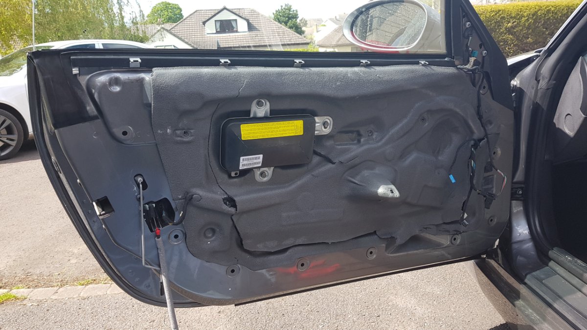

Completed the sound deadening mod on the passenger side today. Nice and simple, took 2 hours, other side will be quicker now I know what I'm doing (includes 25 min wait for the side airbag).
Was slightly skeptical about this one but the results are fantastic - well worth the time and money (thanks WonkeyDonkey for the suggestion). I love these simple changes that I'll appreciate literally every journey.
Slightly disappointed to find someone has had the door card off before, and took the easier way through the membrane (i.e cutting a hole in it) but I don't get any water in the car so one to keep an eye on. What will I find on the driver's side :D
Only have a boring 'before' picture, I completely forgot to take one of the deadening applied!

Excellent! For the time, cost and improvement, it's a very rewarding no-brainer :)

Added sound deadening to the driver's side today.
Same story with the membrane, in a bit of a mess:
Sound deadening added, seemed to be a bit easier today and used more 'complete' sheets without jigsaw puzzle cutting, even remembered to take an 'after' photo :)
