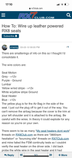

- Sgr74
- Posts: 653
- Joined: Sun Feb 26, 2017 9:56 pm
- Location: Sunny Fife, Scotland
Seats
See if this helps.Jpm wrote: ↑Wed Feb 05, 2020 11:38 amIm new on the forum and have next to zero knowledge on wiring so forgive any discrepancies.
I'm interested in having some rx8 seats retro fitted. Unfortunately my BMW guy isn't familiar with the Mazda's do you have any diagrams that could shed any light on the process to get it to function properly?
- CA7A7099-A0FA-42E2-BD51-E06B73548753.png (219.35 KiB) Viewed 835 times
