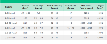

I'd like to think mid 5 seconds for my 2008 si. I always quote 5.5 if anyone asks me, I'll have to get the missus out with the stop watch
Parkers guide for what its worth:

If the official time was set on old runflat tech, and you’ve now put Supersports on, then I think you could take a couple of tenths off.
Plus it depends on road conditions, clutch condition, driver aggressiveness, etc.

Afaik bmw only releases an 'official' 0-62mph time (0-100kph) and that is 5,9sec for the prefl 3.0i and 5,7sec for the fl 3.0si (both manual gearbox)
