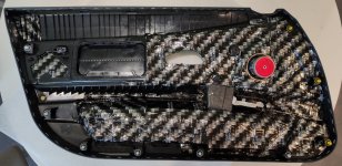

OK, sound deadening added. Overkill? Maybe...
