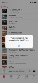

Anyway, I now have shiny new iPhone 7. Which is lovely, but it doesn’t work with the intravee :x
I have a genuine Apple 30 pin / lightning adapter bought when I got my 6 as that wouldn’t work initially and changing the cable sorted it. When plugged in the intravee only sometimes recognises there is an iPod attached ; the phone charges ; however the phone tells me that the device is unsupported ; music will not play. Really frustrating.
I know that the software on my intravee is very out of date - I think the last time it was updated was by srhutch a couple of years ago at least. I never seem to be able to get the update to work :oops:
Does anyone have a 7 working with an intravee ? Did you have to change anything, or make sure the intravee software is up to date ? Anything I need to change on my phone ?
Any help gratefully appreciated :thumbsup:

Well, I’m not alone... it appears to be an iOS issue. The common theme is having the latest iOS version :
http://forum.bmw5.co.uk/topic/130637-ip ... nt-1404824
Figured it is worth posting for people with a 7 who have it working but have not updated iOS yet. Don’t !
I had a 6 that worked fine, but was on an older version of iOS. New phone, forced upgrade of iOS when it was restored, phone doesn’t work with intravee. Hopefully Apple will fix something with a new release and it will all magically start working again.

6S is having the same issue too. A bit of persistence gets the iPhone playing through Apple Music and via the Radio X app, first way is to disconnect the iPhone and re connect it, allowing a few seconds between disconnections, and eventually the phone is recognised with the selected music playing.
Second way is to toggle between the sources and eventually the iPhone is recognised as an iPod and plays music. I have DAB and CD multichanger connected through the Intravee so I cant speak for other set ups but the following error message is displayed on the iPhone when using the second method.
Once connected it seems to remain so but even so this is just a poor workaround. I have a horrible feeling that this is the start of the Intravee becoming obsolete with iPhones due to Apple’s changes but perhaps a future Intravee firmware update can address it.
