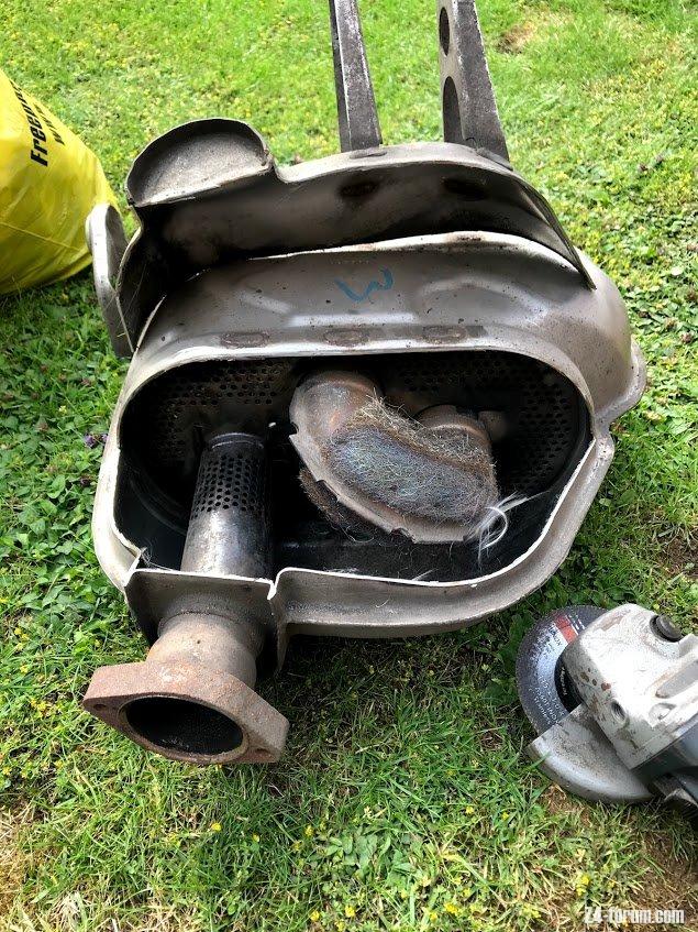

DuckLakeView (forum member) done a bunch of backboxes for members where he cut open the standard box and welded in a couple of flexi pipes to the inside of the back box, I think there is a bit more to it its not entirely a straight through but I have one and think it sounds exceptional (vid below) :thumbsup:
I find that straight up deletions do this sort of "thhhspppp" noise (like daffy duck) when revving whereas DLV seems to have eliminated that.
(in the OP video listen at 0:10-0:11 and 0:13-0:14 an 0:18-0:19 for the "thhhsssp" noise as the revs settle to idle)

I did a back box delete on my car. Bought a second box, cut the guts out of it(not for the faint hearted as I ended up borrowing a plasma cutter, but still had a lot of welding to do!), fitted some 2.5" flexi between the front and back pipes and welded it all up. I does sound good, but I normally fit it for a few months then swap it out for the original box for a change. All in the job cost me £70 (£30 for second hand box, £20 for 1m of 2.5" flexi and £20 for exhaust joining clamps), so a relatively cheap mod.
