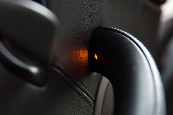

I had this installed on my car too:
I haven't been able to make pictures at night yet (the car is in the workshop).
