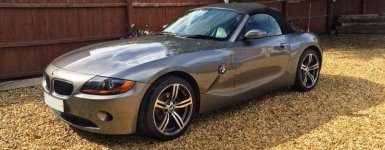

Hello guys,
This is my first post here I bought an 05 E85 a month ago with;
18inch (measure at 19) M6 replicas the tyres are as followed.
front - kumho ecsta supra 225/40/18
back - excelon performance uhp 225/40/18
It also came with;
16 inch stock rims with run flat Bridgestone tyres on.
(both measure 225 width)
However since getting to know the car and how it drives, I have noticed a glaring problem with the handling. Essentially on roads especially uneven country ones, the car appears to weave randomly making me fight it. I have just put on the stock rims and all of these problems have disappeared and i can drive the car how I imagined it should drive.
The problem is that I much more prefer the look of the m6 rims and was wondering if this sort of problem is down to the wheels being lower and offset or the tyres on these rims. I'm not an expert and I just wanted to know if anyone had any advice or experience with a similar problem.
Thanks for any help and best regards!

- m6 rims

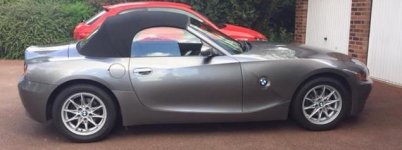

- stock rims

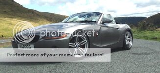

I previously had a 2.5SE on 18" M6 wheels. square set up with 225/40's all round and that handled absolutely fine.
it was lowered on FK springs which bottomed occasionally over large humps but the wheel set up should be fine.
[IMG]http://i1014.photobucket.com/albums/af2 ... 029089.jpg[/IMG]
[IMG]http://i1014.photobucket.com/albums/af2 ... b16c19.jpg[/IMG]
