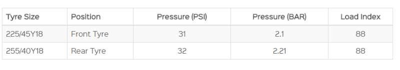

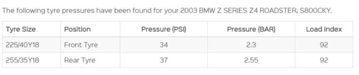

Personally, I'd just ue the recommended pressures for the ///M if moving from run flats, which I will also be doing shortly, going for a set of Goodyear Eagle F1 Asymmetric 3's. just under £400 delivered from Oponeo with the £25 Amazon voucher..
My car on std RFT's;
///M's on non RFT's;
Mike

My understanding is that run flats are inflated higher so that the car doesn't ride so much on the sidewalls (which are extremely stiff in a run flat).
You would never see a non run flat manufacturer recommended pressure for any car or tyre anywhere near that of runflat recommended pressures.
32 f 32 or perhaps 34 rear would be a good starting point for non run flats imo.

For some reason RFT tyre pressures always seem to be higher than non-RFT. No idea why. Driven wheels are also higher than non-driven.
The manual for the M says 30psi front, 32 rear :
viewtopic.php?t=24559
Pretty sure the bar numbers on my door will translate to 32/33 though... will need to check.
On my 3.0Si when I moved to non-RFTs I played with the pressures a little and settled on 34/36 I think.
