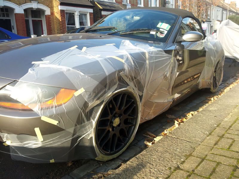

Masking. Use the masking tape to mask the edge of the wheel so that you don't over-spray onto the tyre. Mask all the way around, then switch to the film/tape so that you cover the bodywork around the wheel also. Don't forget to mask the wheel badges!

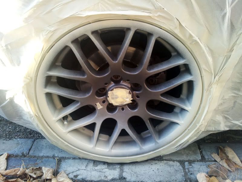

Etch primer. Spray etch primer around the edge of the wheel. I did 2 coats. Once dry, knock back with 400 grit VERY LIGHTLY so your final coat will have a smooth finish.

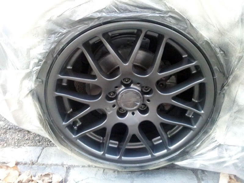

Top coat. Spray the top coat, a couple of coats and you are done. If your wheel is gloss then you need to spray clear lacquer after.

Credit to you for doing it.
Refurbed my own wheels a few times, but can't think I'd ever do it on the car for the sake of 2 minutes to pull the wheels off and do the job without the need to mask and get to paint the inside too.

x2. Good result but overspray on the discs, backing plate and callipers.cj10jeeper wrote:Credit to you for doing it.

Good point on the over spray onto discs, calipers etc.. I'm replacing my discs next month and am doing the calipers red so I wasn't so fussed. Definitely worth putting a dust sheet over if you aren't!
I know what you mean about its not a great deal more to pay a professional but if you have a few small ones its good to DIY!
