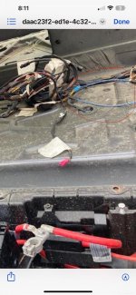

Sub woofer fitting question
You can just see them in this photo here
I think the blue (drivers side) is blue:blue/violet
But you can see how they are run spiralled together

- pvr
- Posts: 26459
- Location: South East UK
Thanks Stuart, that makes it easier to fine. I did spot the blue twisted wires in the loom when I took the cubbies out but they would be very difficult to splice in there so will pull the carpet up at the back to get them from there.
