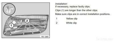

Does anybody know what the difference is between the white and yellow door card clips on the back of the door card on an E85? I suspect the yellow ones may be slightly longer (there are only three on the hinge side of the card)? If so, I can't seem to find them to purchase. Can see plenty of the white ones. Anyone know the oem number for the yellow ones? Ta....

I have used both white and yellow, with no great concern what goes where. Never noticed any difference and I'm pretty sure I've fitted cards with all white a few times.
