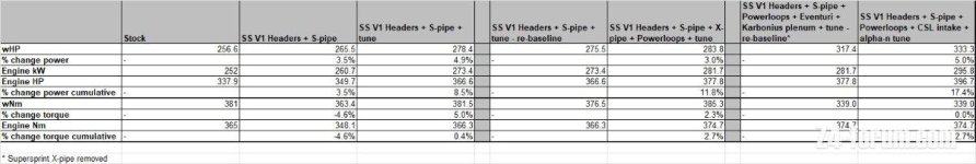

Below is a table showing the gains at each stage of my modifications. Each stage is re-baselined, so I feel like it is a reasonable representation of total gains. The final number is a bit over 17%. If you assume my car was making full power when I started (I know, it's a big assumption), the gains are in the order of 40kW at the engine.
(edit: some calculations were wrong in the table)
