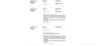

Looking at the MOT history, I would not even bother to look at it. A mixture of tyres, alloys are corroded, driver's seat is also worn

Just saw the previous post about MOT History. The advisories from 2020 didn't re-appear in 2021 so I'm not sure why that would put anyone off.
Tyres can be changed, wheels replaced or refurbed and seats can often be improved no end with fairly cheap products. Just factor in the potential costs.

I can’t agree with Raymond here, there’s nothing serious on the MoT, the alloys are not bad and the seat is an hour’s work with a £15 furniture clinic kit. It’s unique and (if I may say so) one of the best colour combinations available. It’s a tad expensive for the mileage and may need a bit of TLC, but there is probably a deal to be had.

What are people’s thoughts on the 2020 MOT advisory ‘front and rear sub frame corroded’ that doesn’t appear again?

I can only assume that either the rust was treated in some way, probably painted not undersealed, or else the next MOT testers did not bother to note it on successive visits. I have never seen front subframe rust mentioned on a Z4 except for an E89.

All E85/E86 subframes will be rusty to a degree unless they’ve been treated, the front less so. They are very substantial pieces of metal and most testers would regard it as surface rust and not an issue. Some Scottish/seaside cars can be quite barnacle-y. Have a peep under the back, you should be able to see how rusty it is (and the diff). Best way to do this without a jack is lie down on your back, stretch out an arm and take some pics with your phone; or alternatively get one of those mirrors on a telescopic stick.Watson1911 wrote: ↑Sat Apr 06, 2024 7:28 am Morning all and thanks for feedback.

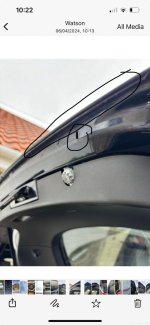

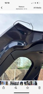

Also here’s a few of the inside of the tailgate. Looks like there could be some rusting coming through but it’s not terrible. I would imagine it will be very difficult to find one for sensible money without a some rusting at this stage!?

I can't see anything wrong in those pictures TBH. It is a sixteen year old car that has 88k miles after all.Watson1911 wrote: ↑Sat Apr 06, 2024 11:09 am Also here’s a few of the inside of the tailgate. Looks like there could be some rusting coming through but it’s not terrible. I would imagine it will be very difficult to find one for sensible money without a some rusting at this stage!?
I agree with others that it is expensive for the mileage.
